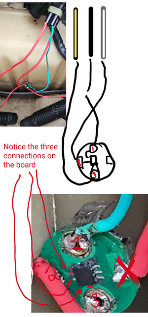

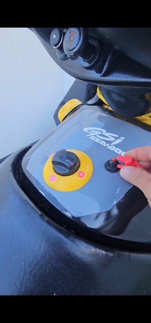

This evening I finally took time to figure out how to wire in my dess key permanently and also wired in a generic marine kill switch and lanyard (needs to be normally open). Everything works perfectly gauges/start/stop/beeps/etc.
$20 for the safety kill switch and lanyard. No other purchases necessary.
If interested I'll send out my doodle diagram or photos.
Here's what I did. Then, just use a N.O. kill and put between number 1 and solid black wire. When the lanyard is pulled, it will open the circuit by removing that ground signal.
Pictures are from testing, not my final setup, obviously cleaned wires up nice and marine Shrink wrapped everything.

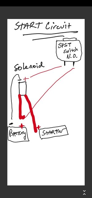

Start : now have to run a curcuit from battery - to starter, and battery positive to a n.o. momentary switch, and from same switch to solenoid +, solenoid - to battery -, solenoid main+ to battery, solenoid main+ to starter +. We are good there.

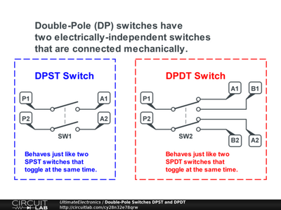

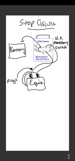

Stop: easiest method is to use a dpst switch and have a wire going to battery - then jumped to each isolated pair on dpst switch, and a wire from first pair on dpst switch to plug 1,and a wire from second pair on dpst switch to plug 2 (this type of switch has 4 connections, each pair isolated from each other, see left illustration). When pressed, grounds spark killing engine. We are good there.
