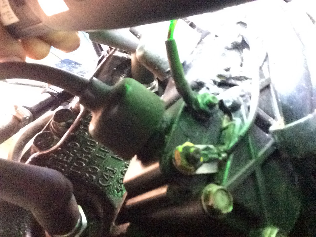

If it's not one thing, it's another! Today, the engine seemed to be running a bit rough, but hardly noticeable? Top sped, was down to about 38 or so. So I decided to use my new spark tester to see what I find. Sure enough, one spark plug was not getting any spark! It was the bottom plug on the port side.
I'm guessing the problem is coil gone bad? Since there is one coil per plug?
I understand to prove that, I would need to swap positions of two coils and see if the problem follows the coil or not?
So now, I was looking at the coil box, it is not clear on exactly how to get the coils out?
