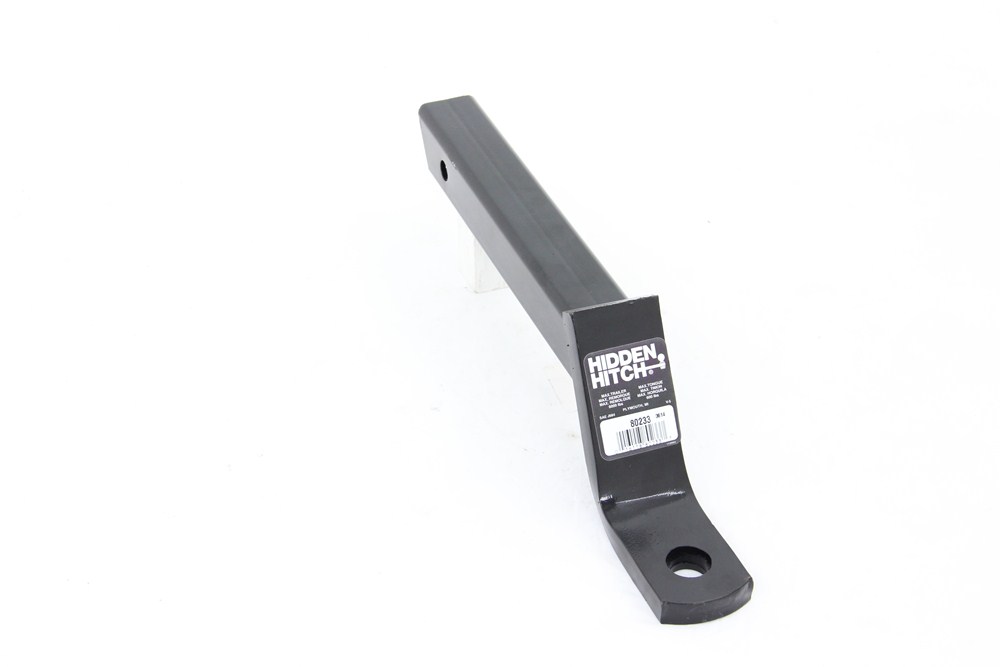

I did look at one of these on e-trailer which might add 3 or 4 inches over my standard hitch ball holder but never bought it.
http://www.etrailer.com/Ball-Mounts/Hidden-Hitch/80233.html

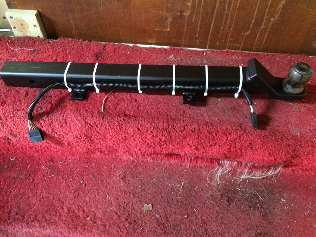

Well I decided to make an extended hitch like the one you have shown only 18" longer than the standard ones. I did a short test towing around the block and it seems to be no problem but after a trip to the ramp I will know for sure. Not really worried about the few extra tongue weight pounds as I tow a 9,000 lb Sea Ray with no issues. I welded brackets to hold the chains and made an extension wiring harness.

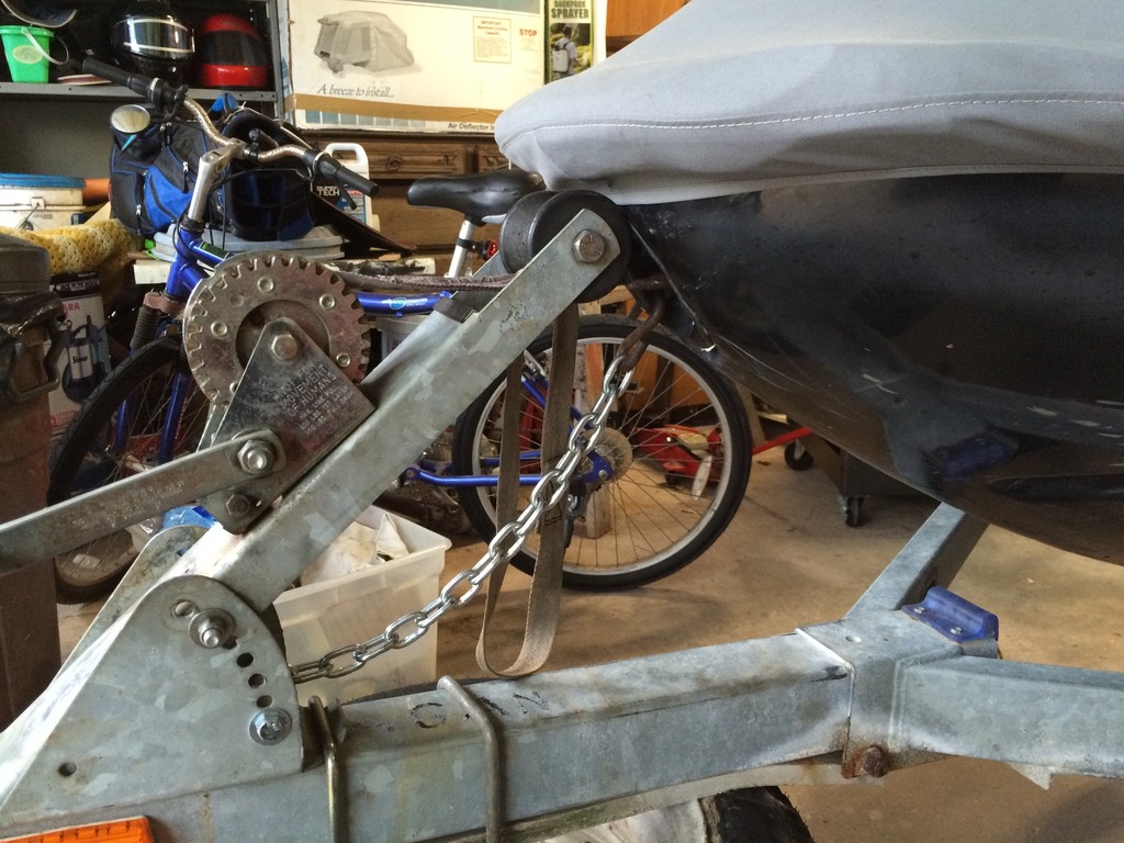

I am also glad I was scrutinizing the tongue of the trailer because I noticed the bow stop was setup wrong. The strap went over the stop roller so one good quick stop and the ski would have launched over the roller. I added a safety chain while I was in there too. I do realize that the best way was to extend the trailer tubing or add the folding tongue, but this drawbar was free (I have access to the machine shop at work) and extending the trailer would require a costly galvanized tube and a complete rewire. I will see how this works and take a picture shortly.
Also my corrected bow roller setup
