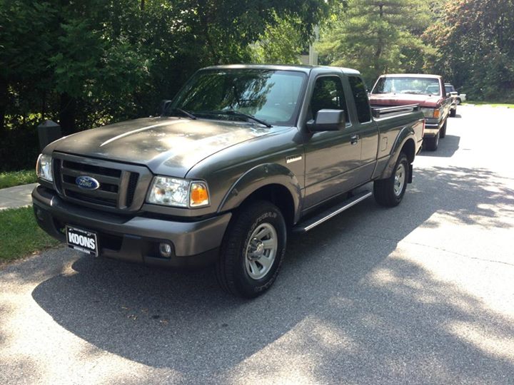

I went to a few dealers to see what I could get for my F150... They had just got this Ranger in Saturday. I asked about it and it was priced $1700 below kbb. They gave me almost what I wanted to sell my truck for, but in MD you don't pay tax on the value of your trade in, so that saved me $750. Payment is $200 less. I feel ok about it. I'd rather not have a payment, but I need a reliable truck and don't have the cash for one. My loan was only 6.5% too, which I think is excellent for a used vehicle. My F150 was 5.5% and I bought it new.
Another problem with buying from a private party, unless you have the cash, you have to negotiate the price, then go to the bank, get the check and give it to the person. Then, if it has a lien, you have to wait for the title to come in. Dealers are easy. Also, a lot of the vehicles I was looking at were an hour or more away. So I was not very willing to have to drive an hour or more, not knowing the condition of the car, because people always hide problems, or any other kind of problems, or someone else buying it out from under you. Just end up with a wasted trip, which happens to me too often and I'm really sick of it. Should be allowed to sucker punch someone who falsely advertises.
It's a very nice truck, and it will be very capable to tow your toys.
