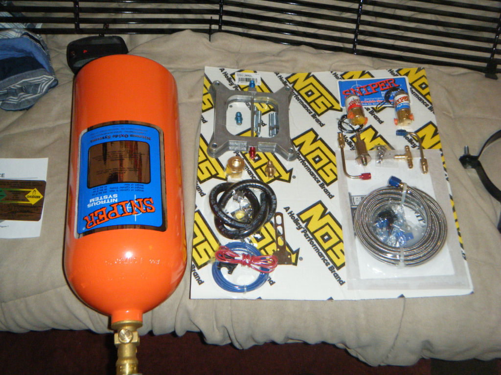

My brother bought me a nitrous kit for Christmas. Should get me up to around 500 hp in a 2900 lb maverick.

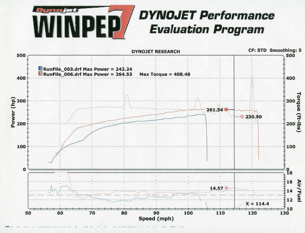

Motor is brand-spanking new, and I run it to 6500 for 265 hp to the wheels. Did a dyno back in November. That estimates to about 330 at the flywheel.
The nitrous kit is good for 100-125-150. All together, about 480 HP, 2900 lbs, calculators on the internet say 10.6s at 126mph in the 1/4. I will believe it when I have the timeslip in my hand.
Check out this torque curve...pink line at the top. 60 mph is around 3000 rpms. Ignore the electrical glitches that cause the peaks. Grounding problem in the system somewhere.

Here is what all comes with the kit...

There is a pretty good bit of plumbing, and it all wants to go to the same places.
The nitrous and fuel solenoids mount right where my dual feed fuel rail plugs in, not to mention I have yet to figure out how to run the third fuel line to the nitrous solenoid.
I will end up re-plumbing the entire engine bay. Braided stainless and -AN fittings are expensive, so this may take a while to get installed and tested.
In fact, I may just cap everything off or remove the nitrous plate for now. I have to pay a couple bills off before I can afford to assemble this add-on.
