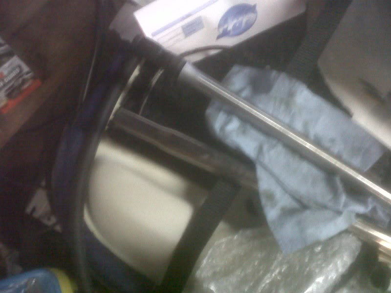

Here is the plate bolted up to the hual. It fits fine.

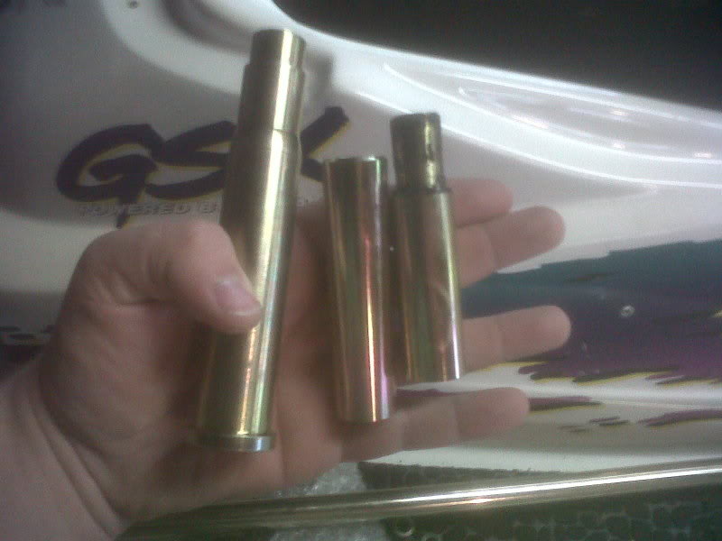

other Plate that doesn't fit.
The adaptors I'm talking about that don't fit into the pto.
And lastly the end of the alignment shaft and the drive shaft.
Am I missing one of the adaptors that go into the pto on the motor or do I use the one with all the slop?
Thanks.
Well just got off the phone with SBT. They told me that it will be fine if there is slop in the adapter that fits into the pto. Guess I will try that and see where I end up.
