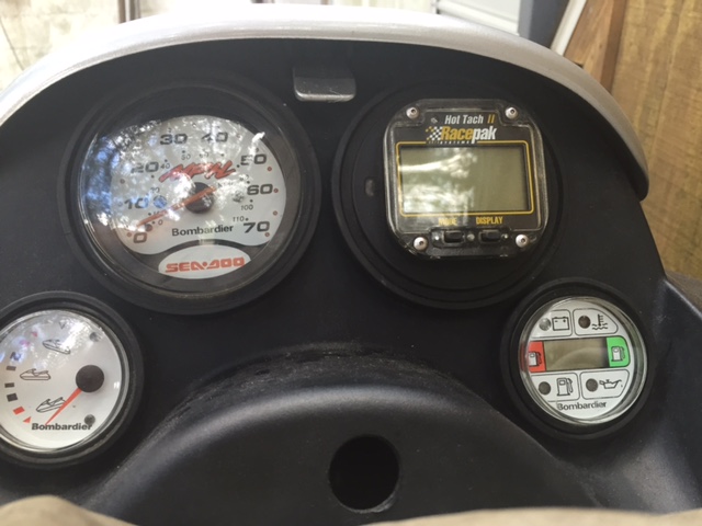

This carbon fiber Watoosee seat was the deciding factor. It's stationary though so no more shock cushion unfortunately.

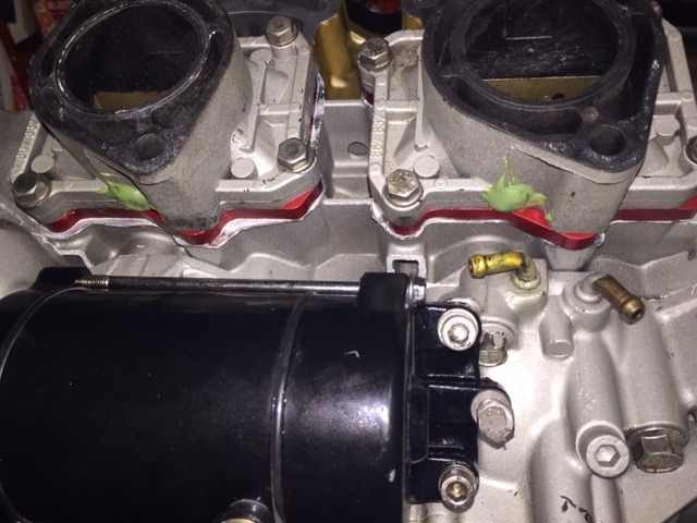

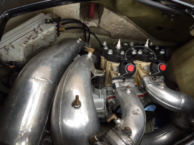

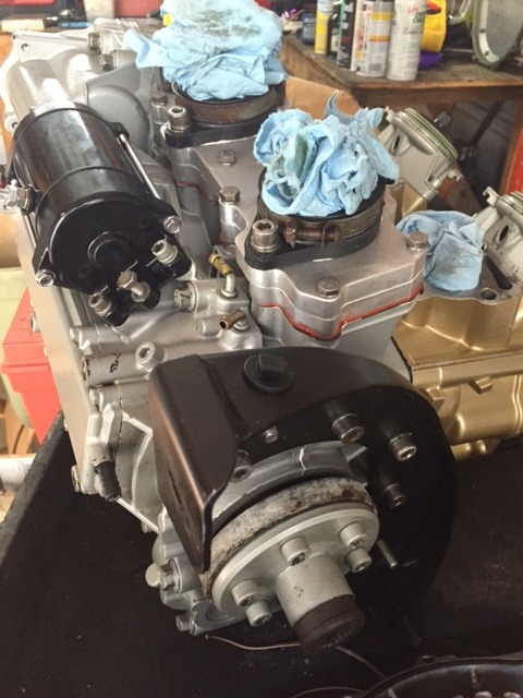

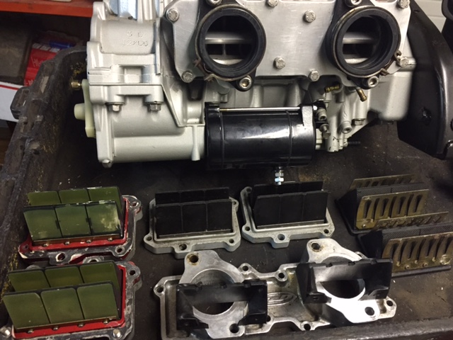

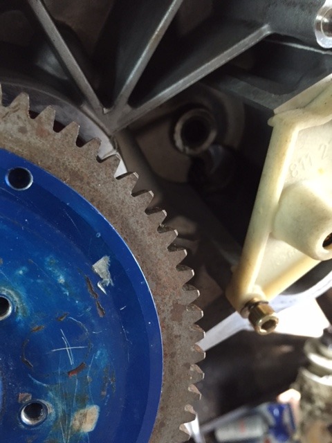

I started with a mint perfect OEM crank and RXX cases that have the case cooler. I found a perfect stock bore top end with ProX pistons. I'm using a Rossier head with 49cc domes and a safe squish of .076. It has R&D M16 billet reeds, a lightweight flywheel and a lightweight pto that is just a stock one turned down in a lathe.

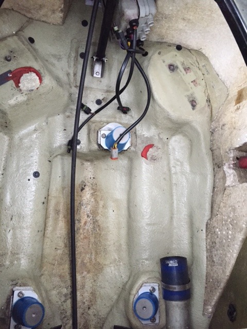

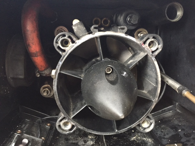

Here is a pic inside from today. I am using RAAS billet mounts to hold her down.
Yes that is a 96XP grey box up there

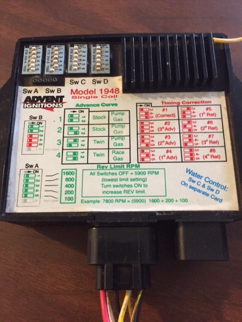

. I'm using a 787 cup on the 951 that will work with the 96 XP MPEM. I replaced the CDI with an Advent Tempest #1948 ignition so I can control timing curves and rev limit.

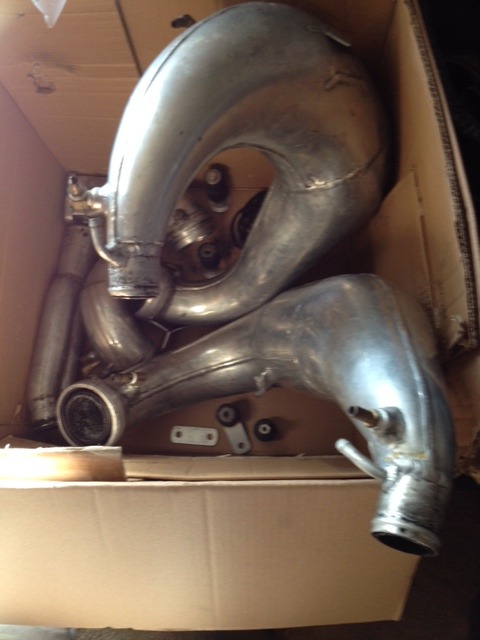

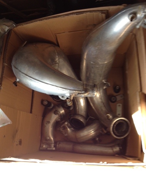

Notice the timing curve choice that says "twin pump gas". That's what I want to do. I have an old beat up set of Factory Pipe long chamber twins that pressure test. These are aggressive but it's what the boat had and I just want to go for it.
