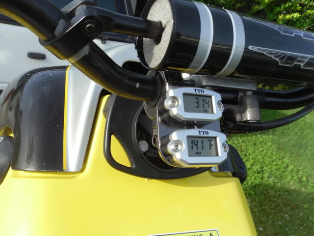

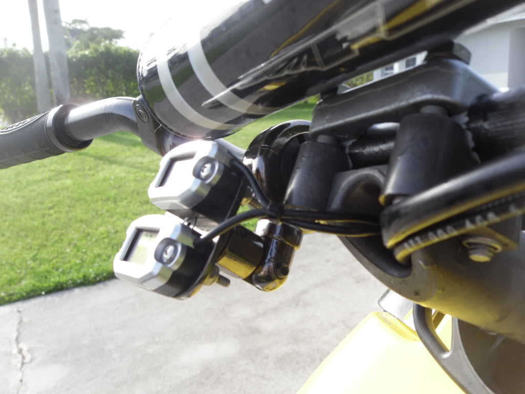

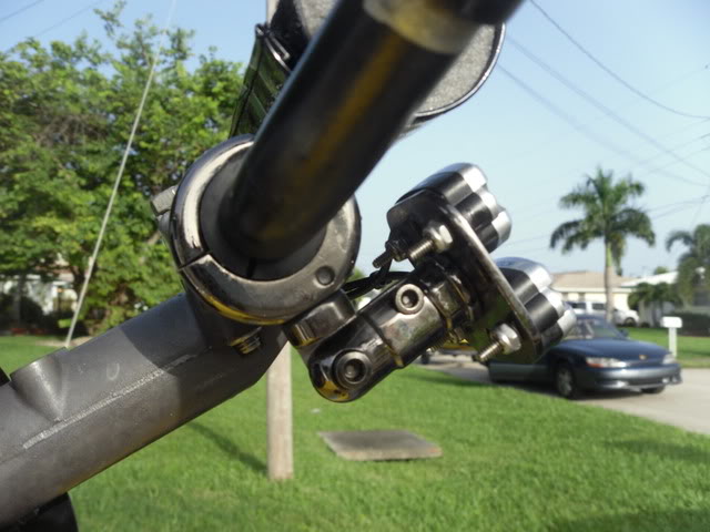

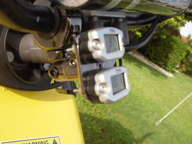

I never installed it (TTO) in one of my personal ski's but I had a friend that loved to install gadgets (has since sold ski) put one under his spark plug, now of course he never overheated but he was basically able to establish a baseline (i'd have to ask him what that was) for a head temp, and kept an eye on it, I guess then he figured he would know if the temp went over his established baseline/comfort zone, there was no alarm that I'm aware of. From my discussions with him, it was partially because he had money to blow and partially because he thought it looked cool to have two tto's on his handlebar (pic below). and lastly because he really wanted to know the head temp...
now I can't say if the location under the plug was the ideal spot, but his ski ran just fine for months and months, so there was no reason to believe that it had a negative impact in anyway placed in that location.

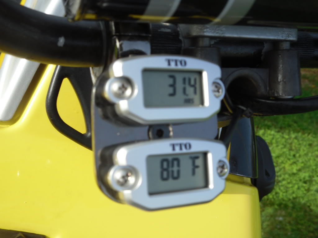

now.. I will admit,,, it looked super cool on the handlebars, and when we were just sitting on the shore or the ski was on the trailer, we had an idea what the air temps were as well... which was kinda nifty... as you can see in the pic below, it was 80 outside when we took this pic :) I 'think' the mounting plate came from summit racing, thats just an educated guess since I swear summit racing was his home page on his browser :)
this was a pic after he fired it up and idled it for a few seconds... temp's jumped up quickly...
