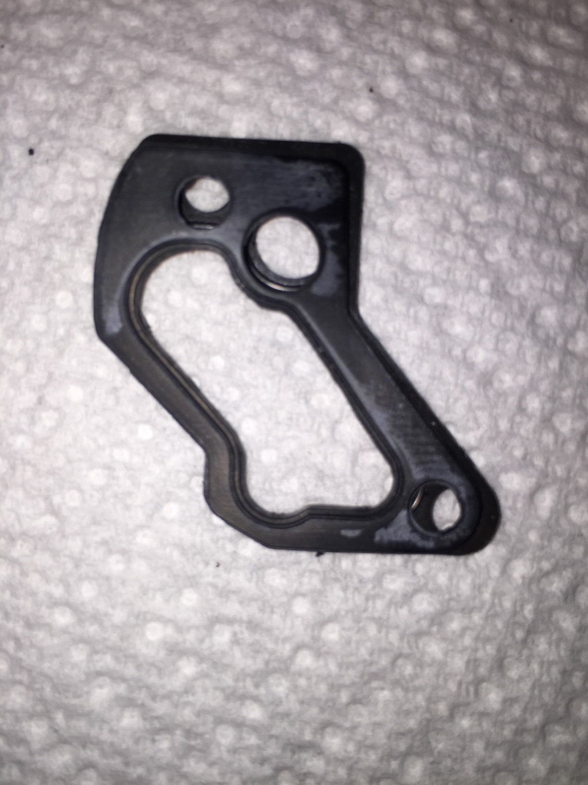

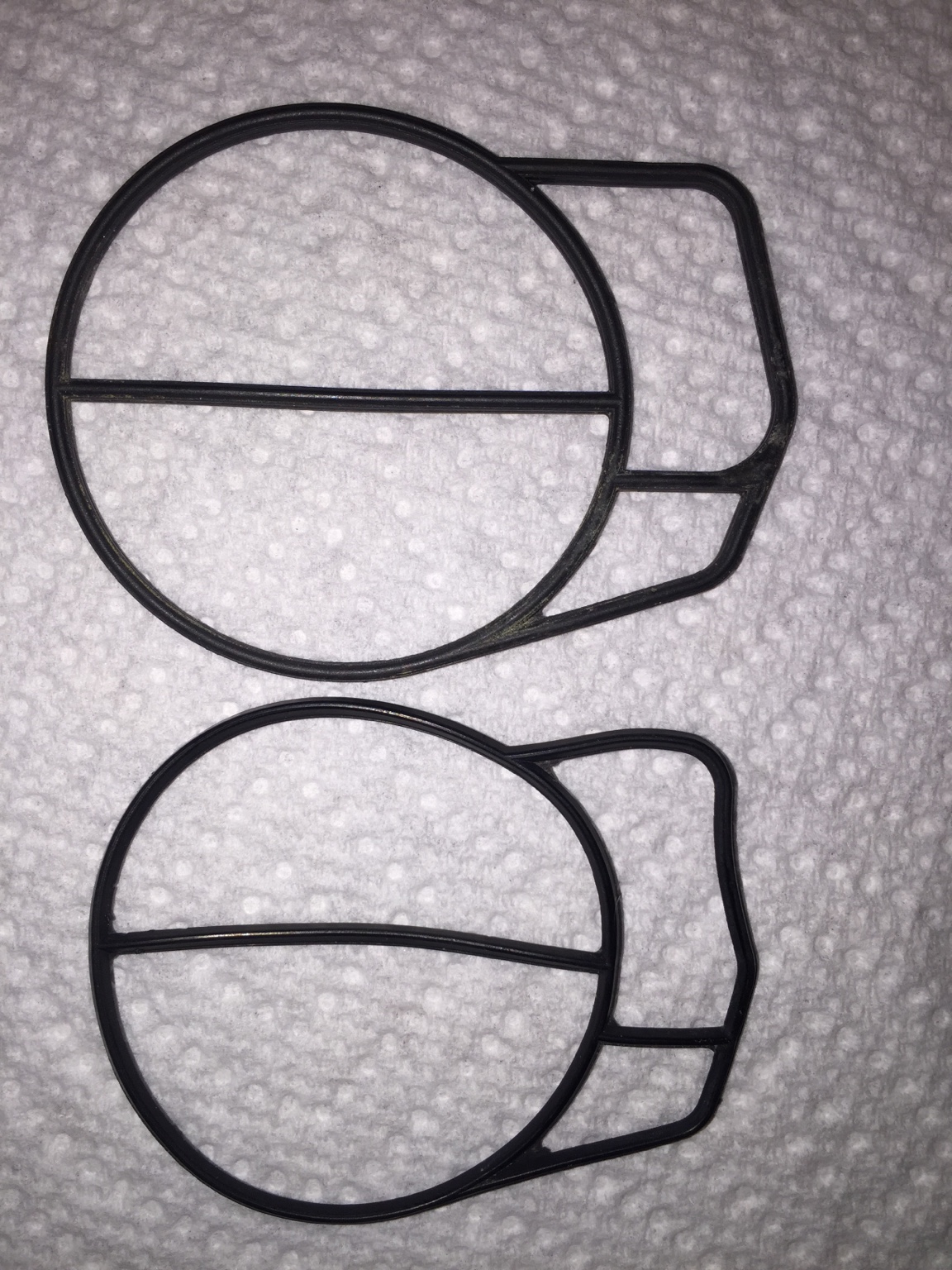

So I pulled the carbs back out at found this
Top is a genuine Mikuni o-ring. Bottom the after market.
Aftermarket gasket sitting on top of the genuine Mikuni
THE PARTS SHRANK!!!!!!!
We tell EVERYONE to buy ONLY OEM kits,,, In your case, you were learning, in other cases, they are being "cheap",,, The reality is, being cheap is at a minimum twice as expensive in the case of the carb kits...
