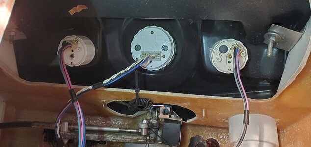

Here's the view under the instrument panel once the seat back is removed. Gauges will need to be disconnected prior to removing the instrument panel.

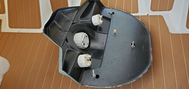

Here is the disconnected instrument panel:

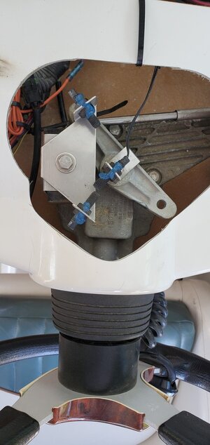

Here's the view from top once instrument panel is removed:
Disconnect the steering assist sensor cable and connect meter to the sensor side. Set up the meter to measure continuity with the audible beep
Check the sensor when turning to the left and confirm the "feel". In my case the left side was working just fine, so I did not make any adjustment. Note the distance between the actuator and the sensor.
Check the sensor when going to the right and confirm the "feel". In my case the magnetic "actuator" was too far away from the sensor to activate it, so I removed the loctite/sealant and adjusted the actuator until it had the same feel as when turning to the left, then used loctite to seal it back up so it wouldn't move.
