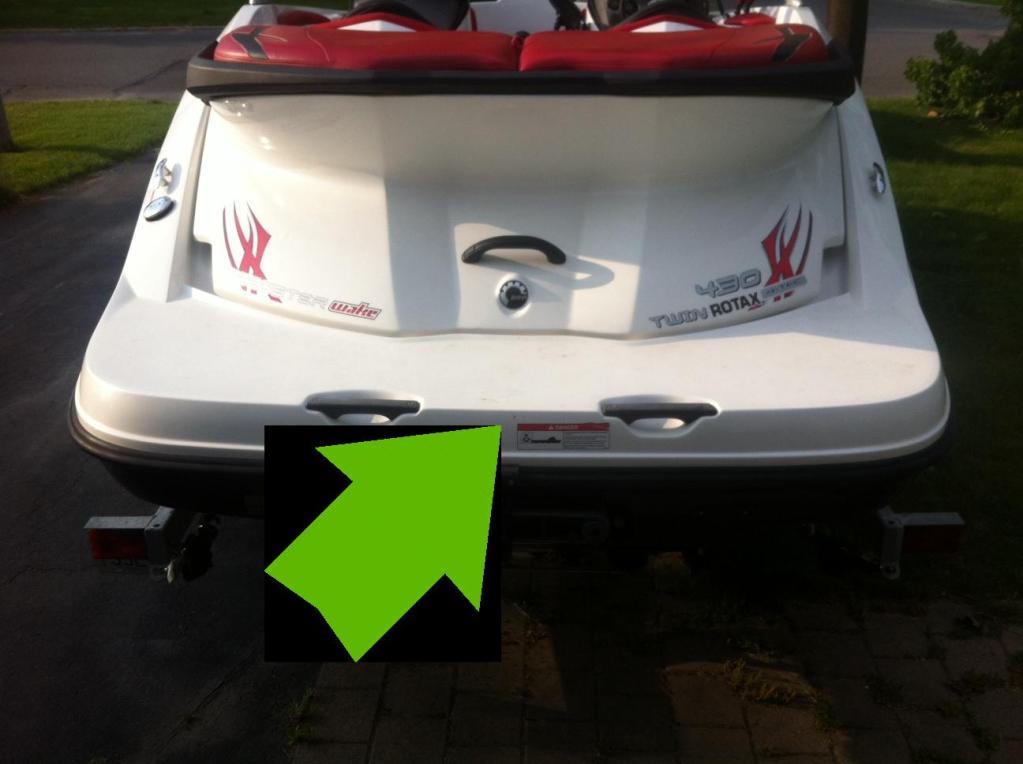

When I bought my 05 Speedster 200 the ski pylon was missing from the rear of the boat, not a big deal for me at the time as it had the OEM tower, anyway, the boat is in at the dealers finally getting the tower safety recall done and so I was not planning on using the new tower for tubing, even though it will be stronger than the original version. I ordered up a ski tow ring (hopefully in the attachment) and was planning on securing it to the transom towards the bottom of the engine bay door under the rear grab handle. I have concerns about the strength of the 'small' nut/backing plate etc that will hold this in place I as I am aware of the drag that a larger tube with 2-3 teenagers on will cause. Do you think I am best to put a metal backing plate on too to disburse the stress over a larger area? Anyone else done this?
