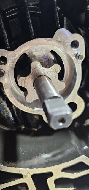

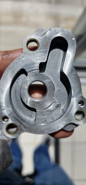

On the secondary pump, there is some deep gouging on the housing and I'm going to replace it.
On the primary pump there is something that made its way into the pump after the rebuild as there's a couple gashes on the pump cover.
I'll attach a pic, but i can't measure the depth, it catches a fingernail, should i replace this cover? rotor teeth and faces are all fine
Also noticed that the water pump impeller had been rubbing on the PTO housing cover and worn a small groove into it, is that normal?
Or did the person who rebuilt the pump not press the rotor shaft into the seal enough?
Wondering if i should rebuilt the primary pump at all or just reassemble this all?
Pump Cover:
Pump rotor, none of those marks catch a nail
