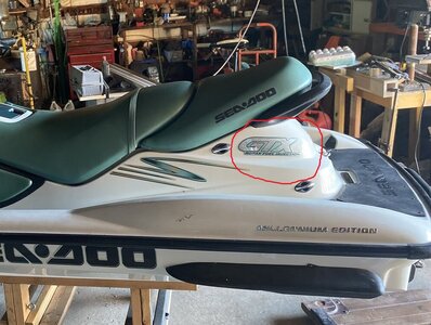

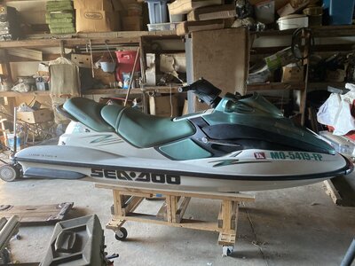

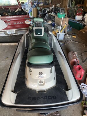

Hello guys, I have a 2000 seadoo bomba millenium edition Rotax Fuel injection that starts fine on trailer and will rev fine on trailer but when It’s on the water it starts just fine but will not take off it has no acceleration the rpm stays low as well it’s not revving high it just bogs.i also checked compression and compression is good in both cylinders. Any ideas on what to check and what to be looking is greatly appreciated. I will add videos of it running off water this weekend if weather allows it.

Pretty sure it’s an RFI
All of the 2000-2002 Sea-Doo GTX 951 Millennium (Rotax 947) are 951 engines. I did find the product numbers showing both carb and DI versions. Since he did not specify carb model or show pictures. I am assuming the 915 DI engine.
There’s RFI’s, DI’s and carbed Pretty sure this is a 787 RFI
He says very specifically Millennium Edition. the 2000-2002 Sea-Doo GTX 951 Millennium are 947 engines. If you he had stated 2000 Sea-doo RFI, you would be correct. That is a 787. But the title is "2000 seadoo bomba millenium edition Rotax Fuel injection" which means 947 DI.
My mistake then

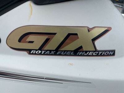

No, that is wrong.
Rotax Fuel Injection is a RFI ski and is what the OP posted in his picture. RFI is not Direct Injection, it is a fuel injected 787.
If it was a DI the GTX sticker below the seat would say Direct Fuel Injection, DI which this particular ski is not.

If the picture in your first post is of the ski that you are working on then it is a GTX RFI 787 and not a 951DI.
There are two of the identical skis across the street from my driveway and I have personally worked on both of them.
If your seat decal says this.....
It is a RFI 787 RFI is literally Rotax Fuel Injection.

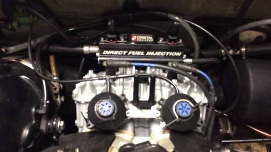

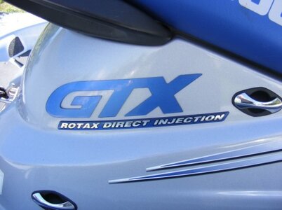

If it says GTX Rotax Direct Fuel Injection under the seat like this....
It is a 951/947 Direct Injection.
Also the DI skis did not come in your colors above, it would have been Viper red or Mazatlan Blue in the 2000-2001 ish years.
BTW: Yours is a 787 RFI.

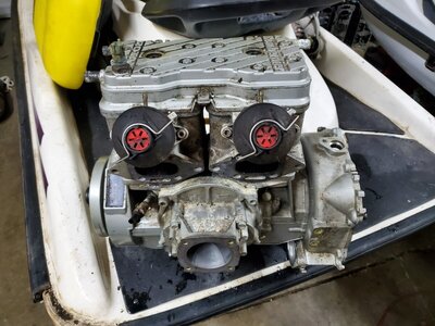

Engines...
787 RFI
951 DI

Engines...
787 RFI
951 DI
Yes the engine is the exact same as the one you said it was. Thank you for your knowledge didn’t even have to look under the seat.
Thank you for all this information I’m definitely going to follow this advice. Ps for everyone wondering it’s a 951cc engine pretty sure it’s fuel injected. I know nothing though so take what I say with a grain of salt I know the engine is 951cc though for sure.
I stand corrected by mikidymac. He is correct. Plus the pictures you put up are a 787 engine and not a 951. so please disregard my post as those directions do not apply.
