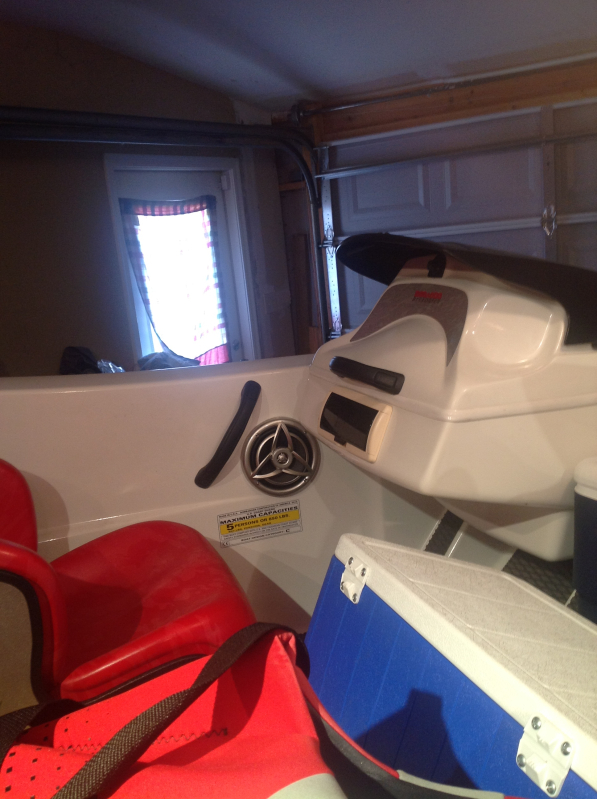

Im going to pick up a Sony head unit and one set of 6 1/2"s this afternoon. I just decided on a standard single din head unit and am concerned about where to mount it. Obviously the wiring harness is on the passenger front but where I have seen people mount them in the past would eliminate the grab bar I have now. Should I just remove the grab bar or mount the unit somewhere else? Also Im assuming I have to cut a hole out to slide the head unit in. How do I secure the unit or do marine head units come with special brackets? Going to try and attempt this tonight so any info would be much appreciated!
I'm on my way out the door, but ill give you the quick answer. You move the grab handle up just above the radio, when your done it looks like factory. Then use a drill to make some holes and cut the radio hole with a jigsaw. It is all really easy. The radio goes in like any car radio, the cage thingy holds it in. I snapped a quick pic with my phone for ya
You give great info sir! One last question, you say the factory speaker wire runs somewhere. Does it run to the front or the rear where you drill the speakers out??
The factory wires run to the rear. The factory speakers are placed between the 2 grab handles on each side in the rear. I made those holes bigger and put the subs there, but this picture should give you an idea. A 5" hole saw will cut the holes perfect quickly.
What do you mean by cage thingy? I mean I think I know what you mean, the rectangular racket you slide the radio into. However yours looks like you used some type of waterproof enclosure or something?
Yeah that little metal bracket thinky that looks like a cage. That is just a cover on the outside. You can find em for like $20. The cover just flips up and recesses back in if you wanna see the face of the radio. Just helps to keep water and sun out of the radio.

Well that was absolutely awful... but it's done. If anyone in the future reads this thread please be aware that the main wiring cluster runs down the driver side of the boat directly where you need to drill. Take your time and all should be ok. Took me 4 hours to do the head unit and 2 speakers. I decided against moving the grab bar as I worry about someone slipping into the radio. Finally I must say I am blown away by these Sony 6 1/2" two way speakers. The bass these little guys produce is outstanding for what they are. I was worried about the factory head unit not providing enough power as well as having only two speakers but I have to say I am 100% happy with the outcome!
PS the factory wiring is MORE then ample, it is a very thick gauge copper.
