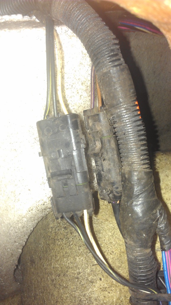

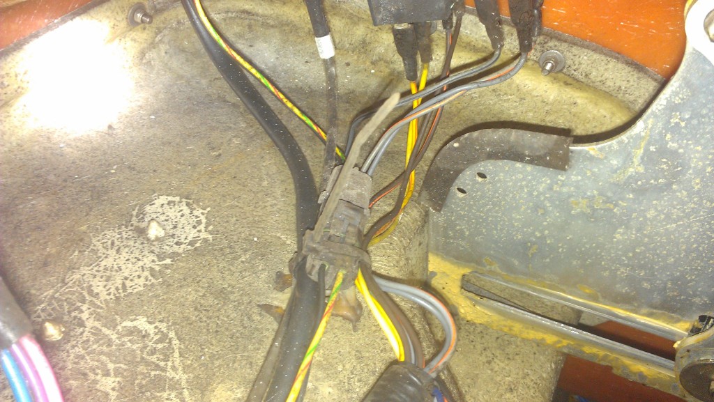

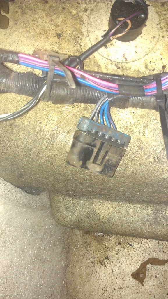

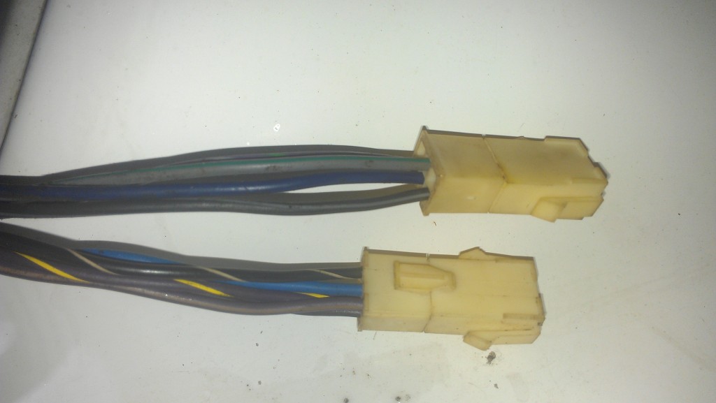

1. I'm positive there isn't a single wire. I will take a pic of the available wires.

1) It looks like there should be a gray/green wire under the hood for the tach.
2) Once you get the tach hooked up, we can get the RPM's set for idle.
