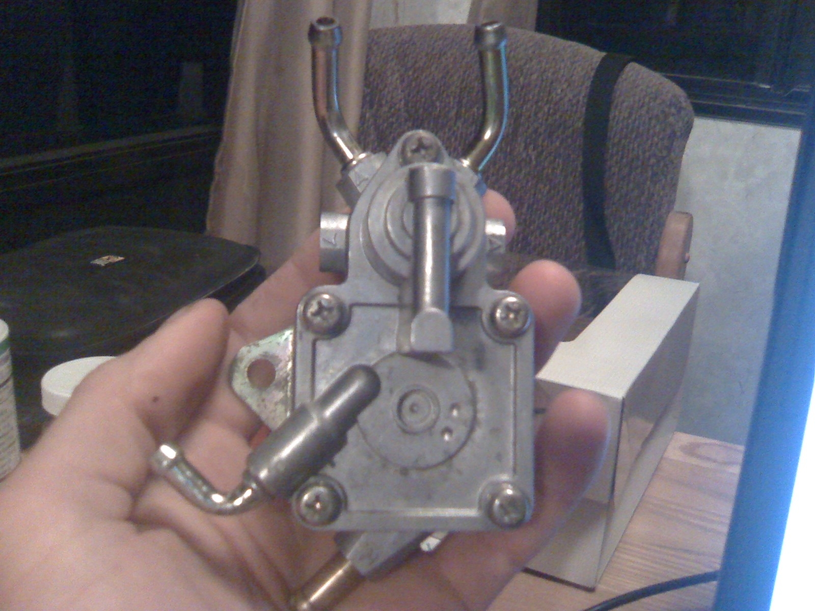

Here's the arctic cat pump.
http://www.arcticchat.com/forum/performance-racing/281421-03-440-sno-pro-fuel-pump-rebuild-kit.html
The fab is not an issue, I have a mill, tig, mig, plasma cutter and the laundry list goes on and on--at my house, and a full machine shop at my disposal 24/7. It's cost VS. time for me. Pumps were in stock at SHSpowersports.com, until they are not available anymore I'll stick with them. Like I said, my Speedster is still pumping with the ones it left the factory with. Arctic Cat Sno pro's have an almost identical pump, again, no kit available. Yamaha did the same with my BIL's outboard, need to buy the entire pump.
wow, my pump does not look like that...
not arguing at all... time I had... remember I started with special circumstances with the PO screwing up the return line as well...
The main body of that Artic Cat mikuni pump is a lot like the OEM Seadoo ones. Minus the extra lines of course. You never know someone in the aftermarket might make the gasket kit when you can't get them anymore. SBT sells the Accelerator pump diaphram since seadoo stopped making them.

I didn't know you could get the pump diaphrams, my pumps although corroded on the outside were very clean on the inside despite the std grey lines still installed. Mine would not work as the diaphrams were really stiff and the pulse was not enough to activate the pump..
