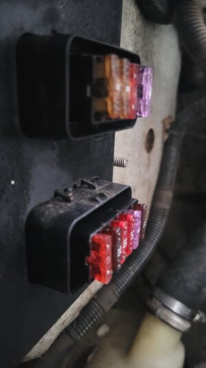

I literally just had this exact freaking issue over 4th of July week on my 1998 Challenger 1800. It started happening after I took the boat out on rough water. New key already, so I replaced the DESS post with a brand new OEM one and no change. I wiggled all electrical connections in front of the dash and near the MPEM with no change. Finally, I pulled the fuse covers off of the MPEM and found that most of the fuses were SLIGHTLY backed out.. Like 1/16th of an inch. The fuses are laid out vertically, and it seems like gravity may have pulled the top post of all the fuses down slightly. I pushed in all of the fuses on the MPEM all the way, and I haven't had a single problem since. Check your fuses and push ALL of them ALL the way in! That worked for me!

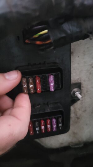

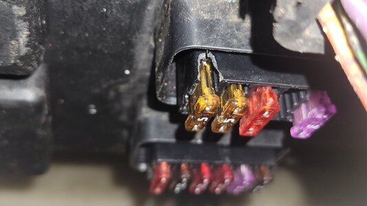

I believe you may have been exactly correct! I pulled the fuse covers off of the MPEM and the first cover (closest to plug in wires) revealed (2) 5 amp fuses that were raised about 1/4" on one side. Looking at the manual, 5 amps is for the MPEM supply. The 5 amp closest to the outside of the housing was finger loose.
Then I noticed that the housing holder for the 5 amp fuse is cracked on one side! No wonder it was finger loose!
I have reseated all fuses and will be testing it over the weekend.
I am missing 2 fuses on either side of the 3 amp fuse. Is your boat the same or am I really missing fuses?
