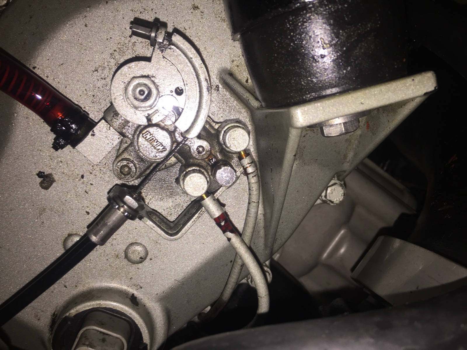

yes make sure the 2 lines are aligned on the oil pump
Sorry guys, I'm confused. I can't seem to find where the two are supposed to be lined up. The pump looks slightly different. Any help is appreciated!
Your pump looks properly adjusted.

It also looks like your small oil injection lines are original and starting to slide off the oil pump. It is a good idea to replace them on these older skis because when they get old and break the engine doesn't get any oil and seizes.
Thanks for the heads up. I'll try to get those done ASAP as well.
