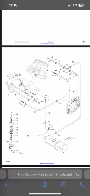

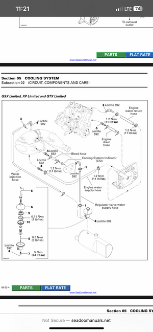

Well, according to the service manual, they had the entire cooling system routed wrong. They had both of the small hoses coming off exhaust expansion chamber near the big clamp Y’d and going out the cooling system indicator port. They had the big lower feed hose on exhaust coming from the port on rear where u hook garden hose. They had feed at rear going to the cylinder head. They had one of the water regulator hoses T’d at the front, and I can’t even remember where they had those going.
That probably cause the damage you found to the hose, it got too hot! Nice catch. Hopefully your problem is solved, let us know.
Alright fellas, conflicting info here. The service manual shows cooling system one way and parts manual a completely different way. The parts manual is how it was originally setup and I changed it all to the way the service manual shows.
