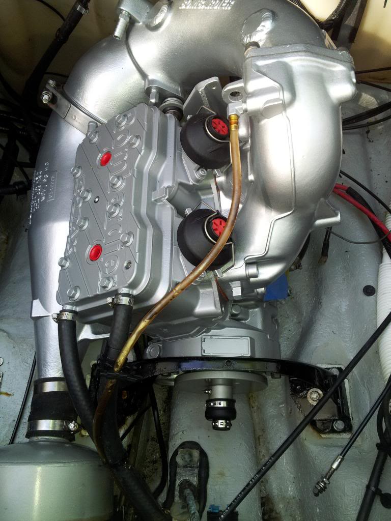

Are you using the hose connection on the back of the boat? If you look you will see a plug and a white wing nut in the below pic. I do not flush my boat thru there, I use the ones under the hatch in the second pic. Also, when you start the engine --THEN turn on the hose, do you get ANY water out the back of the boat near the tow ring(near the grab handle on the back hatch).
You are going to have to remove each hose individually and blow compressed air thru them to make sure they are clear of obstructions. I just repowered a guys Challenger with twin 787's and almost every line on one of the engines was plugged with what looked like wax pollen. This goop shot all over the place. Also, check the short black hose going from the front of the cylinder head cover to the exhaust pipe(first pic), it's 1/2" hose. Remove that hose and check that the outlet of the cylinder head cover is not plugged solid. One of the old engines I removed from this guys boat was plugged tight and casued his engine to overheat. Look at the lower half of the exhaust, is tit silver colored or a coppery bronze/silver by the exhaust coupler to the water box (as seen in second pic, black hose with two large hose clamps)
You can see the large 1/2" hose from the head to the pipe. I would start here. Be careful when removing the hose from the head, they can get very weak from corrosion. You might want to cut it off and hit the auto parts store for some 1/2" heater hose., Then with a mirror look back into the nipple coming from the head. If it's blocked get a shop vac and set it up to suck the crap out while you slowly and carefully chip away at it with a pic or something like a small screwdriver.
Here is the area for you to check the color of the pipe, find the red cap on my pic and look straight down to the rubber coupler, then look forward--Is your pipe discolored ? If so you probably have a bad water control valve too, but you still have to verify the lines from the pump to the engine to the pee hole. Where you at in NY?

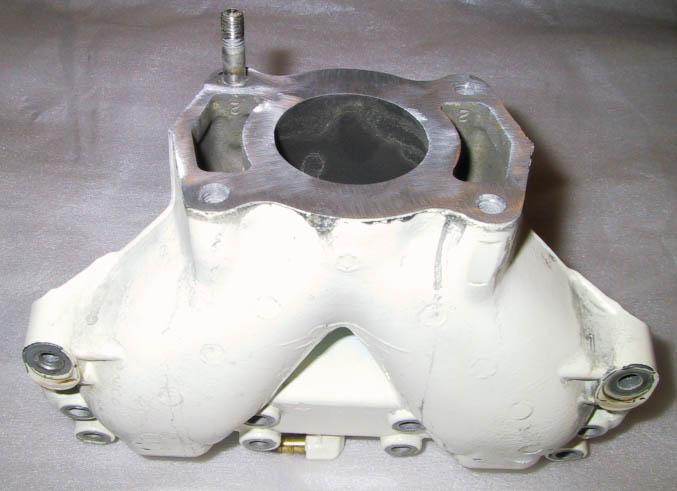

Well, I think part of your problem is, your boat doesn't have 800's, it has 720's. I would assume by YOUR description of where the pee line comes from UNDER the exhaust manifold that your boat is a Speedster SK. I would ASSUME that you also have a hard bow cover. The plain Speedster came with the 800's and a seat up front, no bow cover. Does your engines look like this one? You can see the clear pee line off the side of this exhaust manifold, this is an 800. Also does your engine have the black caps with the red adjusters in the center, if not you for sure have an SK with the twin 720's.
Or does your engine look like this (with a different color exhaust pipe) 2nd pic is just the exhaust manifold

Here is the cooling system, it's very straight forward. The water enters the head on the low side of the two hoses. That inlet line has a "T" in it that also feeds the water control valve. That control valve will inject water into the main pipe thru a 1/4" black line, which will then ride thru the lower half of the pipe and into the water box and eventually exit thru the exhaust. Now back to the engine, the water has entered the low side of the cylinder cover and flows across that and exits the front and into the main head pipe and flows up that and feeds into the exhaust manifold which will fill the cylinders and then exit the cylinder head cover on the upper black 1/2" hose. That hose goes back to where you can connect the garden hose back by the pump. But off the exhaust manifold is the pee line or tell tale line. That is the small 1/4" clear line off the EM and exits the boat near your grab handle, water must come out there, this is your eyes telling you that water is flowing thru the system. It just sorta "flows out". There is also the two calibrated fittings in the bottom side of the cylinders that "T" into each other and will also drain on the opposite side of the pump, iirc.
