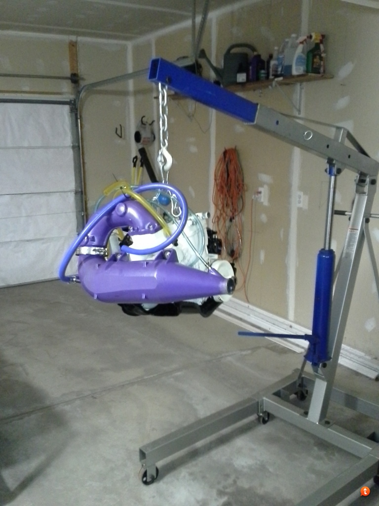

On my 95 speedster I installed the port engine first and had everything hooked up tuned pipe,carbs,oil lines ect.. Then I used a chery picker and hung it over enough to hook up the starter wires then lowered it down to the mounts. For me I tried to have as much Of they assembley process done on the bench to avoid climbing in the bilge and being in awkward positions. It also helps to have a buddy help you out with maneuvering the lift basically your only obstacle will be hooking up pos and neg starter wires wile it's hanging other than that it's pretty easy at least on my boat not sure how your setup will be though.

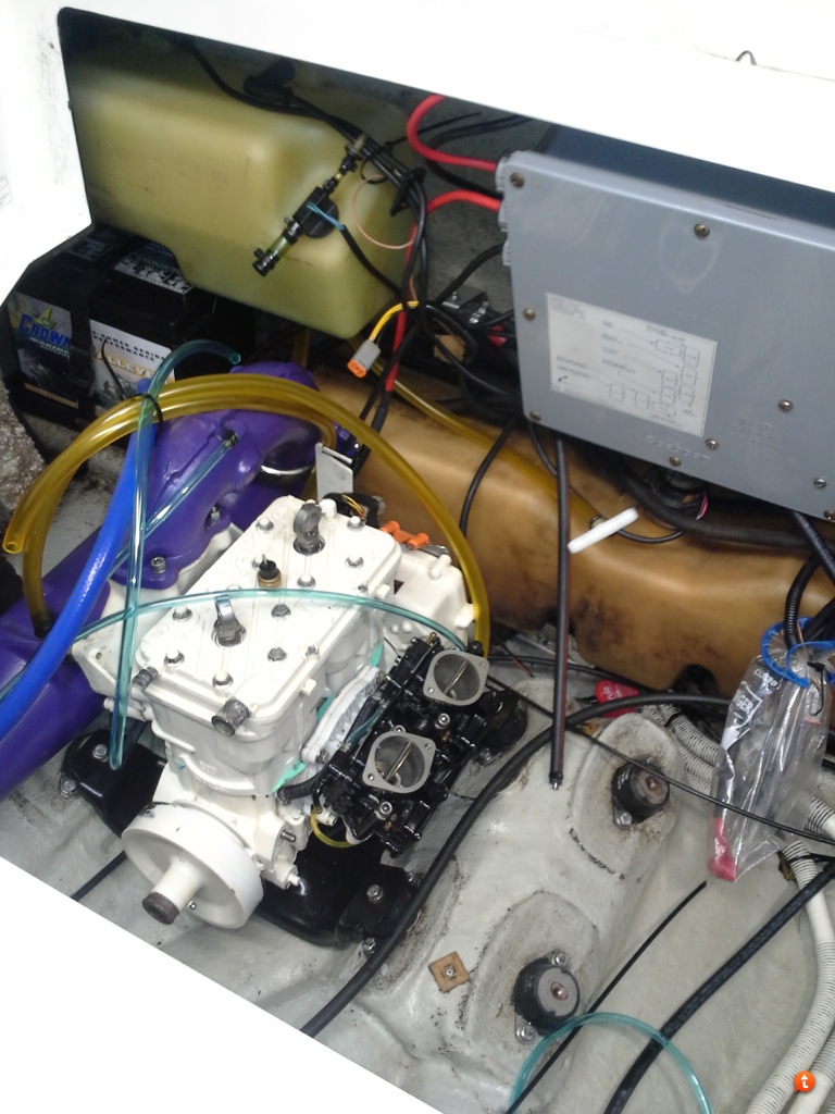

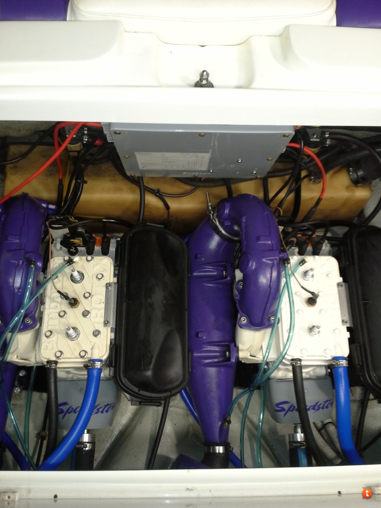

With the portside I installed all lines the tuned pipe and carbs but not the flame arrester because the starboard tuned pipe won't fit into place with that in the way but I have 657x engines yours are prob a little different. Also before I installed the starboard I hooked the throttle and choke cable up along with the gas lines.Then I installed the starboard with the tuned pipe on but not the carbs just because I figured it would be difficult to hook the cables up because of limited space on the starboard side wall. On the starboard carbs I hooked the cables up before I bolted it down it just ended up being easer that way. If you use new oil lines you should leave them a little long so you can hook them up while the engine is dangling from the lift. All in all it's not that bad you just have to do a little planning. Before I put the starboard in I finished up everything I could on the port. Here are a few pics I dug up from my install.
