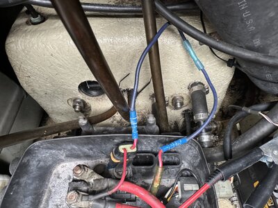

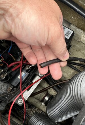

And finally one more line that goes from the pisser on the port side into the hull toward the back. Once those are all on should be done. I just can’t find where they go
The line that’s coming out the port side and heading towards the back, is your battery located at the back. Port side? Could be a vent hose for old acid batteries?

As for the battery, yes it’s in the back, port side. That hose fits right to where the battery is located so you’re probably correct there

The pic with the hose going to the hull does look like the battery outgas hose, they are not necessary anymore but leave the valve in place, it is a check valve .
The pic with the tube in your hand, not sure but it may be the other end of the battery outgas hose, if not sends us a picture of the other end.
