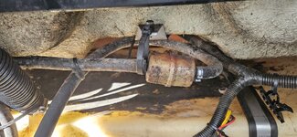

1998 challenger -- a bit of a thread hijack here. i also have what i think is a fuel delivery problem on my right motor (got the boat last week) i looked at the inline fuel filters and besides looking old, the right side is installed backwards with the arrow pointing towards the tank, not the carb. i searches and searches but dont seem to be able to find a replacement, can someone point me in the right direction?
Thanks and sorry for the hijack
Dave
