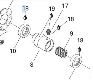

T treatcg New Member Jun 10, 2024 #1 I believe the support joint in the diagram (#8) should not be spinning with the driveline. What would cause it to spin?
mikidymac Moderator Staff member Moderator Jun 10, 2024 #2 No, it should not. Either the bolts are loose but more likely is the bearing seized.
