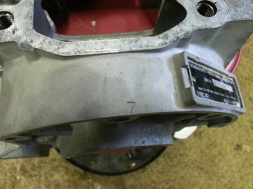

It could be timing as each engine is different. Only way to check timing is with a BUDS or Candoo programmer. If you have your old engine look at the top of the arch of the case where the rear engine mount mounts and there should be a number stamped into teh case, like a 2, 4, 6 etc... that is the timing. See what your old and new engine are. I'll try to post a pic.
You can see this case is a 7, I have another that is a 6, another that is a 5 and another that is a possibly a 1(hard to read filled with paint), So if that was a 1 and I put it in a ski that was timed to a 7 it might not run 100%.
Not saying this is the case, but something that needs to be looked at.
