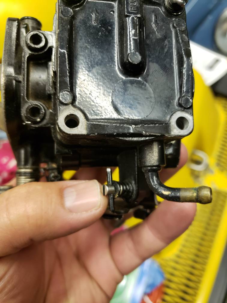

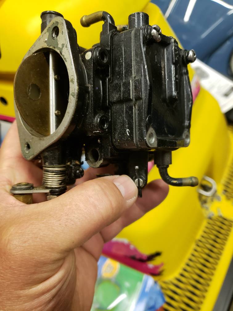

twothxtrm Member Apr 26, 2019 #1 Hey guys! I cannot find the idle adjustment screw. I know, I know n00b. Anyone have a pic or tips on how to access?
mikidymac Moderator Staff member Moderator Apr 26, 2019 #3 It’s hidden behind the throttle cable bracket. It’s the one pointing down. It IS NOT the one going into the side of the carb body.
twothxtrm Member Apr 26, 2019 #4 Ok thanks guys! Is it accessible with the stock airbox installed? Can’t seem to get a finger on it. Seems that it should be somewhat easy to get to for on shore adjustments lol
twothxtrm Member Apr 28, 2019 #6 Thanks everyone! I know how to “feel” for it. Idles perfect now in the water
