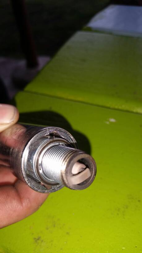

also had thease plugs in for a day on Saturday maybe ran for about 20 min then took it to the lake today and ran for about ten minutes.(won't start after first ride) Does it seem like I'm running to lean? If so I need to turn my low speed screw counterclockwise to richen it up a bit correct?
