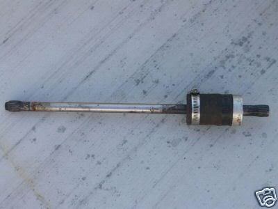

Here is the typical carbon style seal
you'll have to remove this accordian seal and pull the carbon ring back to pull the c-clip

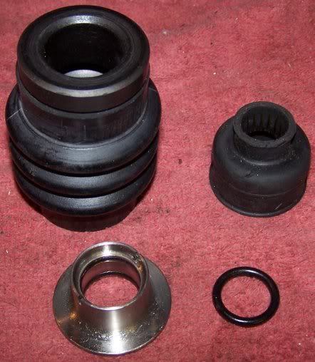

I would install this type of seal. It is the updated carrier bearing style seal with a grease fitting. More reliable.
Also, don't forget to change the neoprene seal when you pull the pump to take the old carbon seal out.
