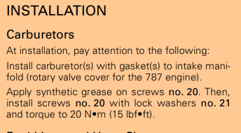

Is this from the shop manual? Which shop manual are you using? The instructions you posted are for a 787, it may not matter but... there was a manual from 2002 that included 951 carbed model. Which torque specs are you looking for again? The 4 bolts that hold the carbs to intake?
I found this off seadoomanuals.net it was from the 2002rx. I couldn't seem to find one for the 951 so I'm assuming its the same and yes the 4 long bolts that hold the carbs too the intake.
Yes, I’m pretty sure 15 pounds is correct. Had a look in my 95 manual and it’s 15 pounds in there. Found it in Fuel System section 6 sub section 3. My manual says to use blue loctite on the threads but I would just go by the newer manual. Torque them gradual, I usually do 2 torques first and then my final torque just to ensure everything goes down straight and even. Not sure what they call for but a little 518 on both sides of the carb base gasket wouldn’t hurt.
Check the 2002 manual again, I was looking at the 2002 manual this morning and I thought it included the 951 RX
