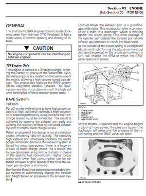

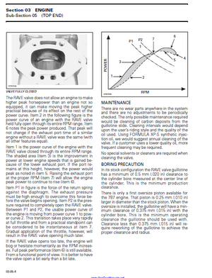

The RAVE valves open around 4500 RPM giving you the burst in power.
There is no RAVE valve on my engine. The 1995 XP shop manual says nothing about it. My engine is a 717. What's your next best guess to explain the sudden increase in RPM?
Well, it is a 2-stroke so there will be a powerband. It has to do with the expansion chamber and porting so yes, they do come alive at a certain rpm. Known as coming onto the pipe in 2-stroke terms and yes, these do start to sing at about 5,000 rpm.

Sorry, assumed you had the 787 model since the raves open at that same range. When mine are running optimally, it feels like my arms are being jerked out of the shoulder socket!
