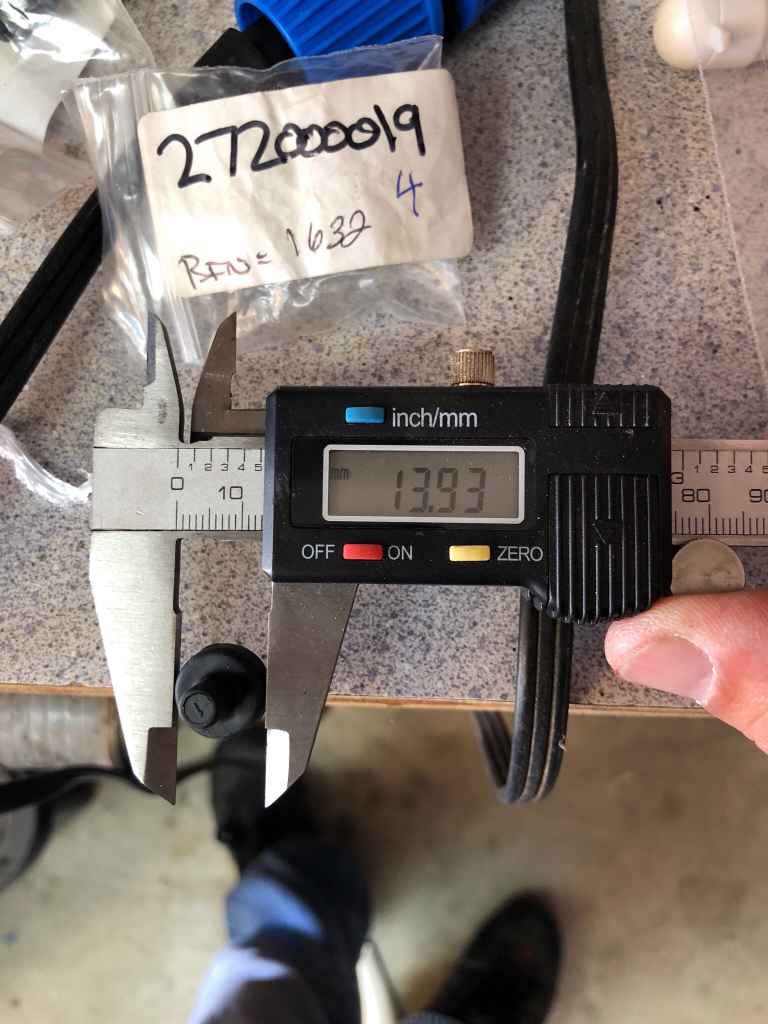

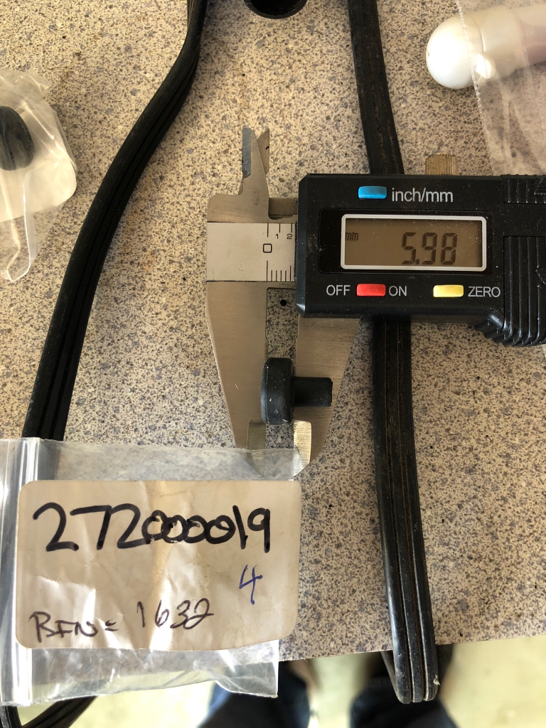

Edit: Hmm, the bumpers are smaller than the one I already have on the impeller end (i.e., not as thick and would actually mean the drive shaft moves further into the impeller boot) and the part that sticks into the drive shaft is too big and there's no way to push it in. I think I got "shafted" on these bumpers. Or maybe someone used the wrong drive shaft?
These are what I bought:
NEW DRIVE SHAFT BUMPERS SEA-DOO 1995-1997 HX 1997 SP 1996 SPX 1995 XP 720CC | eBay
