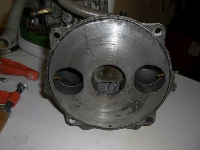

OK so I took your advice and also went a little further, I took off the carbs cause I figured they could use a nice cleaning and I found a couple of intresting things:
This rubber boot was like this when I remove the carbs:
What exactly does this part do?

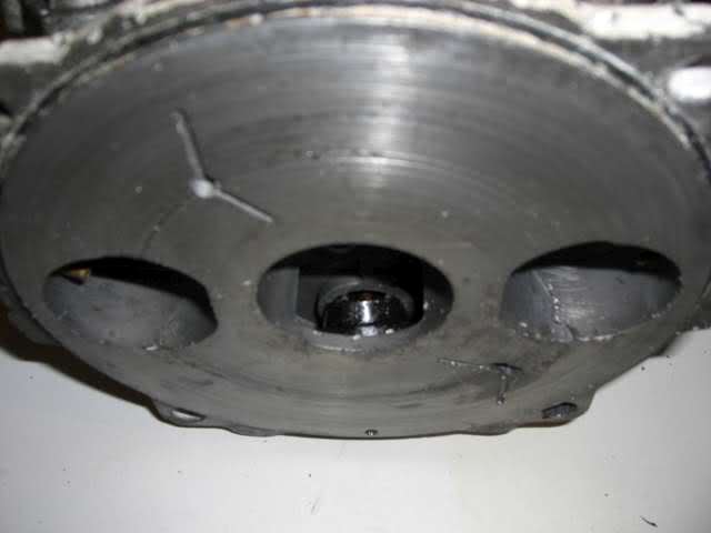

Also is it normal that this surface is so scratch up?
If so can I smooth it down a bit or should I just leave it alone? Also what are those gold things on the side of each intake? they don't seem to have a hose attached to them.
And last what is this assembly for? it seems like some kind of linkage but nothing was attached to this.
Thanks for all the help!
well, the plate in the first picture is the rotary valve cover...it looks pretty scored up and could use replacing. How does the rotary valve itself look? If you pull the Rotary valve off, it has to be placed back in the exact place or you will have to set the timing marks up again with a degree wheel so it is in time. That item under the carb in the last picture is the 2 stroke oil injector pump. I bet the last owner had a seizure problem and discounted the injector pump and went to premix. The 2 brass stems in the intakes of the carb is where the oil flows into the engine when injected by the oil pump injector. Do you have a manual? If not you might need one to help repair the problems in the picture...here is a suggestion;

Since you have the Rotary valve out or the engine I would pull the heads and look at the condition of the cylinders and pistons/ rings. I bet it will looks as bad as the Rotary Valve Cover. If it does it will not be a cheap repair...
