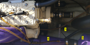

the engine has this quick connect and thats where I attach the garden hose and water comes out of the weep hole and the jet pump housing, so do I still pinch the outlet hose or no?
No, you don't need to on yours.
Some have a Tee on the hose going to the head and if you don't pinch the hose the water will go out the back instead of into the engine.
No need to pinch, there’s no hose there to pinch. 657?
The hose to pinch if you wanted to on his is the big black hose off the head adjacent to the flush port. That hose just goes back to the jet pump. In theory you would get more flush pressure to the engine by clamping that hose.
Yes, I know. Just explaining that this engine doesn’t have that hose, on other engines where he attaches his flush connector there is a T fitting and a hose that goes out the stern but not on this one, hose just terminates so nothing to clamp
Oh, gotcha now, That must be the water inlet then. Yes, never heard of pinching it to flush. Better read my manuals again.
