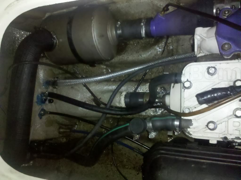

The newest issue is that after a sustained 40ish minute WOT run (by a friend who is a little too comfortable on it), the first rubber exhaust coupler failed. I replaced it with a Fernco 4" rubber coupler, but it didn't last 5 minutes (it's a plumbing fitting not really meant for heat). I'll order the right part, but I think I have a cooling issue. I've taken the tuned pipe off and blown air through the 4 ports that I can find on it (two should be supplied water by the pump, and two are connected to each other according to the manual).
Unfortunately the manual is missing a middle section of the coolant hose diagram. Would you all take a look at the pic and see if I have things connected correctly for a '94 with the 657?
The clear hose at the top of the photo (port of ski) splits near the tuned pipe and feeds both nipples at the front of the pipe. It doesn't move much water from what I can see at idle, and it's kind of hard to tell at speed. Air seemed to flow freely blowing backwards through it...
Why are there two ports on the low pressure side of the pump? I have one capped off.

Thanks for the feedback, Bill! It's much appreciated, but I'm not sure that I see the incorrect portion.
Using the labels from the Bombardier image:
Both of my #13's are connected as they should be.
My 21 (exhaust manifold to exhaust @ exit of ski) and 24 (head to exhaust @ exit of ski) are, I believe, correct.
The #2 from the back of the head in the diagram just shows a connection to a flush 90* fitting. I'm not sure swhich port that would be on my '94. I currently have it connected to one of the two ports in the center of the hull associated with the pump. I think that's a relatively low pressure area that should help "pull" water through the system.
The #2 going to the tuned pipe splits and feeds the two barbs as shown on the diagram (only closer to the pipe inlets), but I'm not sure that it's connected to the correct port a the rear of the ski. The diagram doesn't seem to help me figure out which one that should be. Currently it's connected to the one on the port side of the ski.
Please forgive my being dense. It comes naturally!
Thanks, Bill!
Please forgive me for being dense, but I truly appreciate your help!
I'm not sure that I see what is incorrect, so let me try using the Bombardier labels,
#13s One connects the bleed port at the top of the tuned pipe to the inlet near the exit. One connects the head's smallest port to the "pisser"
#21 connects the exhaust manifold's port to the exhaust just before it exits the ski
#24 connects the largest port on the head to the exhaust just before it exits the ski
I think all of those are correct.
The hose from the rear of the head to the pump should hit a low pressure port at the pump, right? I may not have a correct understanding of the pump, yet, but I think either of the two ports in the center of the hull would work, so I chose the one on the port side.
The hose that feeds the tuned pipe does split (just close enough to the barbs on the tuned pipe that it doesn't show in the photo). The diagram shows it connecting to the pump (and I assume it has to be the higher pressure port), so I guessed that it was this single port on the port side of the pump.
Did I guess incorrectly? I can't tell from the diagram.
Thanks, again!
The head port small rear is a flush adapter only, looks like you have yours in the large starboard. Your jetpump suction looks connected to head small on portside. weird.
