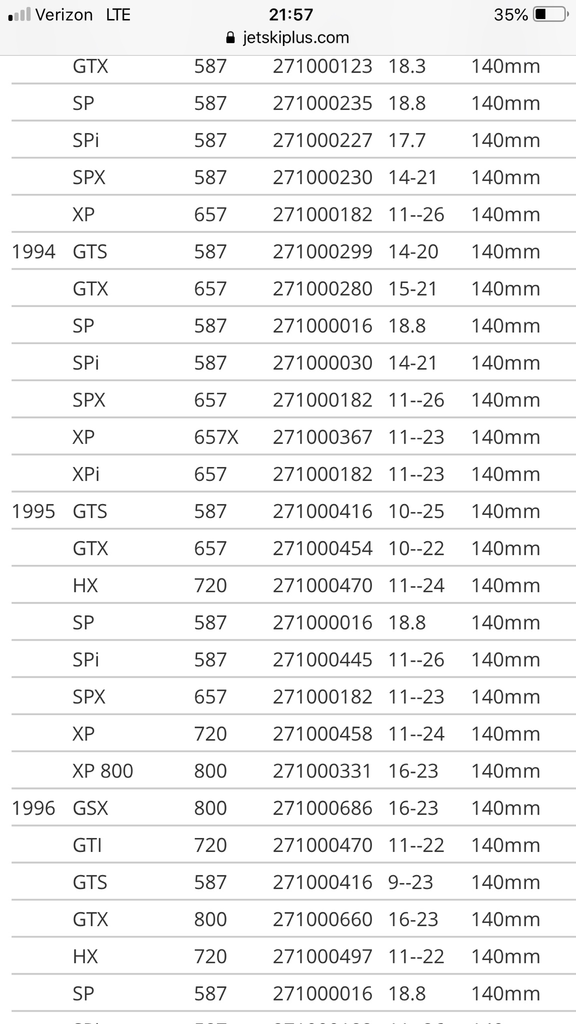

Anyone know of a chart or correct size for a 94 spx .587 motor wear ring size? I ordered a blue one off eBay that Said it would fit..when y I went to put it in ,it just dropped right in with no help,I installed the impeller chrome blades and it was super tight?.. with the tape measure I’m getting about 160mm on the black pump case IDfor where the OD wear ring should be pushed into place

Ok thank you for the chart ,it looks like they sent me a 139.5mm wearing so 140mm sounds like it will solve my problem, thank you for the help
