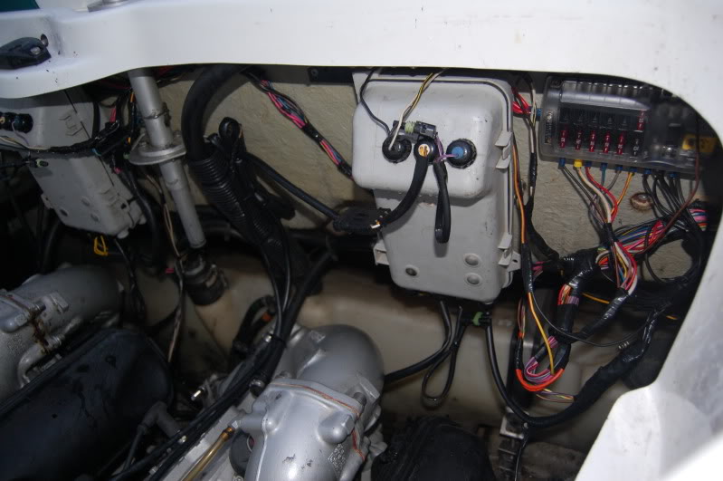

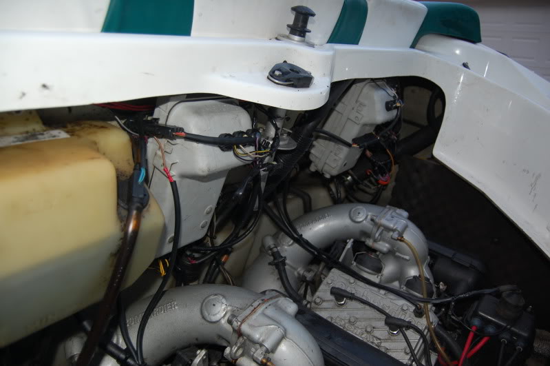

Yes you can, its running great, 2 MPEM instead of one. had to add a lanyard for the each side.

The only main difference in the DESS stuff on the new ones and the newer ones have that direct fit plug to the harness that will be different on the boat than the ski. So you want to find one that doesn't use the plug since it will be hard to it make it work. The pictures above is exactly what people do. They took the whole electrical box and mounted it on the boat.
