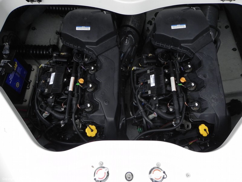

In between both engines centered in between the impeller housings, pushed closer to the back of the hull.

If you stick a screwdriver through the drain plug hole, it will hit the bilge pump. I'm not sure how I would ever replace it without cutting an access hatch into the floor of the rear wet locker.
With my 2010 challenger I can get to the bilge pump, it's a stretch and very uncomfortable but I could replace from the engine compartment if need be. When I bought my boat the boat had been sitting for sometime and the hose from the bilge to the hull fitting was plugged.
The auto bilge doesn't kick in until there's quite a bit of water in the bilge. If you want to test it, you can install the drain plug and fill the bilge with the hose. Pump should kick on even with the battery switch in the off position.
You should be able to see the pump without having to remove anything. If water gets more than half way up the pump and it still hasn't kicked on, then stop, as you may have an issue (dead pump, blown fuse, etc).

What's missing from that diagram is the muffler that conceals the pump.

Just replaced the pump on the 210 this weekend. OMG what a massive PITA and might be the worst job i have ever done on anything. I had to take off the starboard air box and muffler just to even get close to the pump. Once that stuff was out of the way I was able to lay on the engines and get in there. Unless you get lucky and find the exact same pump, you will also have to replace the base (comes with new pump) but note that they rivet that thing in; not screws.
