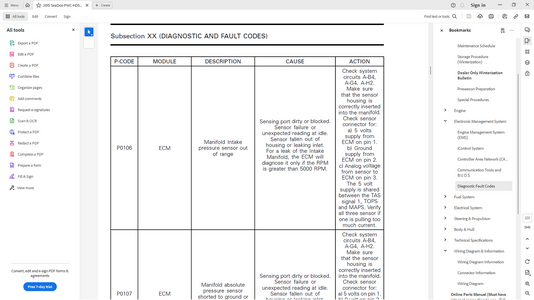

Maybe a hose or the sensor fell out ?? Sensor failure could also be the culprit . Look at this screenshot , maybe it will help , good luck.
Thank you , I will take a look . I can’t see It being more then just a leak from the sensor or the sensor is bad as the ski only has 44 min on It .
