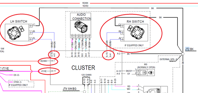

There is one person who added the ski mode and started a thread on it here. There are several details missing from that thread that I have painfully figured out. The connector that goes into the RH keypad is a Delphi GT 150. You are better off buying a complete kit from any electronics place rather than the connector from seadoo warehouse since theirs only comes with one terminal and seal (you need 3). I had to buy packs of terminals and seals separately to complete that task. The connector on the cluster side is a 20 pin molex MX150 rectangular connector. Read their guidelines on how to assemble these connectors. I had to order specialty crimpers and pin extraction tools for each of these connectors. I also went ahead and ordered a spare 20 pin molex MX150 connector because I needed the terminals and wanted to practice on one that was an integral part of my electric system harness. Alternatively, I could have just ordered a set of terminals for ~$6-8, but the extra $14 was a cheap insurance/training tool for me. Disconnecting that molex MX150 connector is tricky, see attached image showing instructions on how to do it. You have to pull the red tab AND push down on the latch for it to release. Once you disconnect it, you will need to remove the plastic plugs on spot #4 and 15 (see diagram) and this is where you need their specialty overpriced tool. You can check the color codes on some of the other pins (circled in red) to make sure you are installing them in the right spot. Pierreye mentioned something about the pin out on the diagram being wrong. This is somewhat true. If you look at the connectors for the LH and RH keypad on the diagram, it shows pin "C" at the top but if you consider one is pointing left and the other right, you realize that's impossible/not correct (if the one on the left is at the top, then when flipped to point to the right, pin "C" should be at the bottom). On top of all this, you need the ski module and find someone with a BUDS2 megatech (expert) license to switch the "type" from "rental" to "SE" per pierreye's post (see earlier link).
