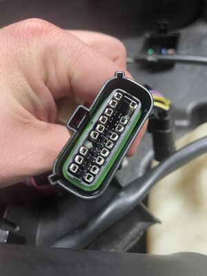

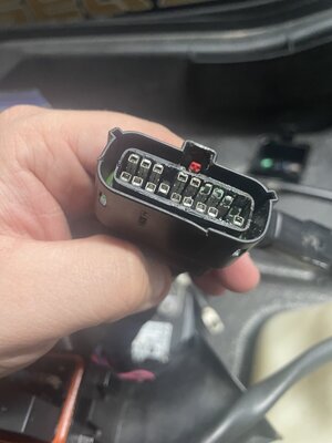

I decided to deep clean this today and decided to disassemble the connector. This is what I found. Kind of shocking adding grease took the code away. Safe to say this is getting replaced
Not too bad replacing it. The plug is a Molex MX150 connector, $20 later and we should be good to go 428058EC-250A-4E1F-A45D-2829886AFF5D.jpeg
