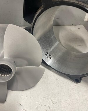

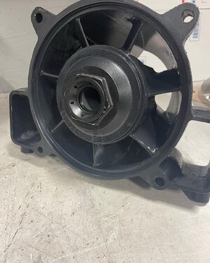

Thought I'd do a follow up on this. I got the jet drive all taken apart and the impeller, stator and wear ring sent off to Impros. Turn around time was a little less than a month. These are the before and after pictures. They do an awesome job! Going to take it out in a few weeks once the weather warms up a little and see how the repaired parts hold up.
