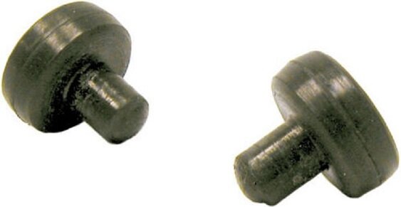

There is a rubber bumper at each end of the drive shaft. One on the impeller end one on the PTO (flywheel) end. You drill a small hole
through the center of the bumper. It will stay in position better.

When you push the bumper into place on the drives shaft the trapped air pushes the bumper back out. The hole is merely to make it less likely to push out but rough handling can cause the bumper to become dislodged. If you can turn the impeller with your hand the engine won't have any problems with it. Start the engine or hit the starter to see if the engine responds as it should.
