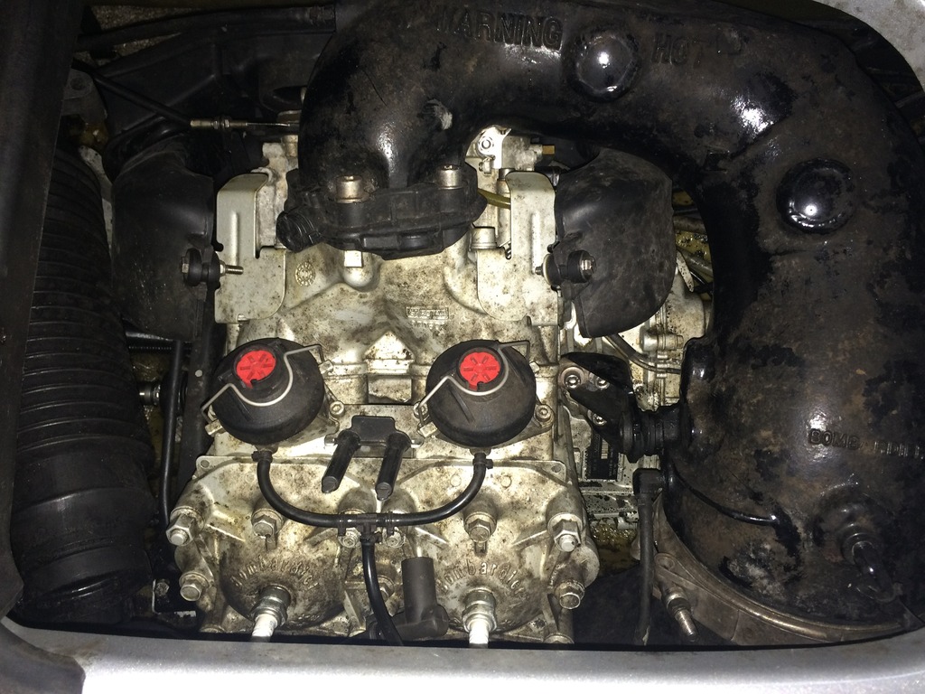

THIS THING IS ONCE AGAIN CUTTING OUT UNDER LOAD! jUST SPENT $1600 IN REPAIRS. RUNS GREAT IN DRIVEWAY i REPLACE THE PLUGS AFTER EACH USE, CHECKED THE FUEL FILTER, THE TANK HAS BEEN FLUSHED DEALER THOUGHT i GOT WATER IN TANK, i AM ORIGINAL OWNER, THE BOAT HAS ONLY 51 HOURS, ANY IDEAS?

Man, that's the 951 DI motor. This thing is a beast to troubleshoot. But my guess would be either a problem in the compressor injector or compressor. May be in the fuel regulator or compressor air dump valve.

About the same as my 35' boat!!! I had the thing worked on in Washington and brought it to my place in Arizona so I can hit the lakes when in town and I still just can not keep her running. I never had this kind of trouble with my last 3 skis and I purchased them used. I need to stop complaining and start fixing. I am thinking of checking the fuel pick up filter and if not that it must be electrical? Anybody have any ideas?
If I pull the forward plug wire she dies, pull the rear plug wire she still runs, I have spark to both wires. she is not smoking so I think she is starving for fuel I only know how to check the basic stuff.

There was a guy in here, TXTOBY who had the DI motor and he had a domino effect where it went back to the shop several times to find the root cause of the problem. It ended up being the air injector to the rear cylinder.
The DI also uses your compressor to operate your RAVE valves. Some of your description points to that possibility. I'd look to see that you don't have a RAVE valve stuck open. You say that both cylinders have spark, but one dies when you pull the plug. This would be the cylinder in question as to the RAVE sticking open.
Make sure you read up on the procedure on checking the air pressure that operates them. This could be as simple as a clogged air line to your RAVE valves.
