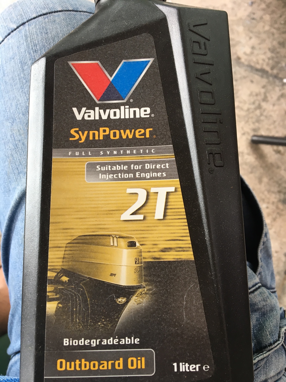

I know this is a topic that's been beaten to death but I could not find the specific answer when searching. I used to use the quicksilver pwc synthetic BLEND 2 stroke oil that came in the gray bottle with the pink graphics on it. I've been using it for years but now it looks like no one sells it anymore. It looks like it might be discontinued. I ended up finding it at online at west marine and ordered it but what they sent me is "Quicksilver PWC 2 stroke oil FULL Synthetic". I suspect because it really is no where to be found. Normally I wouldn't fret over synthetic blend vs full synthetic but nowhere on the container does it say low ash or acpi standards. This is what it says on the bottle "for use in oil injected or premix applications". "Meets the needs of all 2 stroke PWC and sport boat engines" and "exceeds Jaso FD and ISO EGD".
Is this OK to use in my 657x? And/or what is the replacement for the quicksilver pwc synthetic blend that I can't find anywhere?
