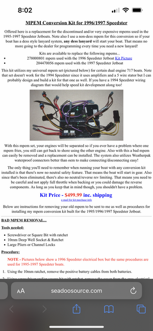

Hey guys I have a 1996 speedster . Couple years ago put 2 new motors in it. Now I have lost the original mpem in it. It keeps blowing the 5 amp fuse. I’m looking into getting the new retro fit kit from seadoosource.com. I have talked to the guy a couple times about doing it but just curious if anybody else on here has pulled the trigger on his kit? He only takes money orders for doing the work and that has me a little nervous specially in this current scam happy world. I’m not saying he is that person just wanted to know if anybody else has worked with him before. This is the kit I am talking about.

I bought mine at Westside motor sports. 97 Speedster. I paid $1,600 for it. Works great. Not sure about this one. Sounds a little cheap. It also takes 3 months to get it back.

Did u wire up the mpems? I’m just trying to get this boat back up and going and hate to send some guy $500 bucks for mpems and not get them or get screwed over on the money!

Yes I was just trying to get information cause for the mpem kit they only take cash or money orders. They don’t take credit cards so with all the scam happy people out there just wanted to be better safe then sorry. I appreciate the info on them and will get a kit ordered and get that boat back running!!

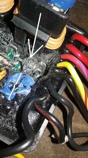

My rectifier was shorted internally so it sent 12v backwards to the MPEM. I replaced the MPEM with a used one and my mentor told me to just plug it in and see if it works. At the time I did not understand anything about how the electrics worked and the ski promply blew the $80 replacement part. I now have both my old units repaired. I thought I'd use them as test units but I have not had any issues with that sort of thing. I connected wires from the MPEM to get the diode out where I could reach and replace it easier in case it blew during testing. :D I never needed it again. That was 5 years ago. I couldn't find any pictures of the diode location in the MPEM at the time so after I get into it... I posted a bunch on the internet to help people. If you find pictures on the net... they will likely be the ones I posted. :D
