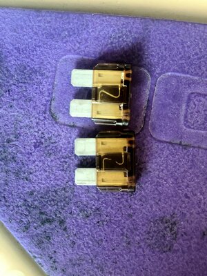

I had this gtx out today and it stalled and would not crank back over.
This 5 amp fuse is blown. What would be the cause?
Start/stop button tests good, kill switch tests good.

Have a look at this, this isn’t the thread I was looking for but there’s good information here. I’m really thinking it’s the diode in the MPEM. If your searching, search like this “ MPEM diode repair site:Seadoo forum.com. to get the best results from your search

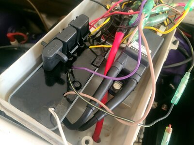

100% a MPEM failure. after replacing the fuse it ran for a bit on the trailer and the MPEM released smoke magical smoke. Strange the fuse didn't blow while on the trailer just fried the MPEM. But I figure it was already on it's way out.

Does it look so bad that it couldn’t be fixed, if your not going to try the diode fix I would like to give it a try, I would pay the shipping and give you whatever is fair.
I've rebuilt GM gauge clusters before. Never anything that melted like this.

You had between 12.34 and 12.6 volts while running, that’s very low. I have no idea barely at all about all the electronics but when searching “blowing 5 amp fuse” I did see a number of posts where the rectifier and the stator where suspected. Those volts are to low while running, I would wait until Someone who really knows what they are taking about replies before you put that MPEM from your other machine in, in case the issue damages it as well.
My volts were pretty low while it was running.
I know the mpem failed but something could have caused it like the rectifier or stator.
From the reading I've done seems when the 15amp fuse blows that is a more common stator and or rectifier issue
