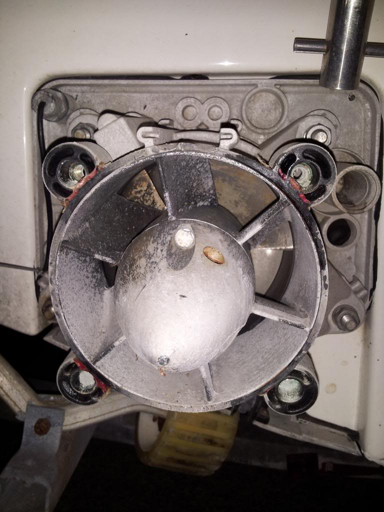

Just pay attention to the hub size(the center of the pump). 98 and down SHOULD have the small hub pumps, 99+ SHOULD have the large hub pumps on the boats. If you bought a pump from Minnetonka4me you're not getting a POS. I'm sure other guys on here are not out to screw anyone.
Small hub pump--look at the diameter of the cone
Later small hubs were plastic
Large hub pump-- Compare the cone diameters you can also see how short the veins are

Interesting. Someone on here tried to sell me a large hub pump for my '98 boat, said not to get a small hub pump, said it would bolt on, but not work well. Glad I doing some homework first...
I've owned i/o boats for 30+/- years. I can rebuild a merc motor, Alpha One and Bravo One outdrives. But I feel like I'm starting over with my first jet drive...:banghead::confused: Well I guess I am...
If your boat is a twin you really should have it matched, at least I would. If it's a single a large hub will work, just make sure you have the impeller to go with it.
EDIT:You really need to verify what you have NOW, then go from there.
