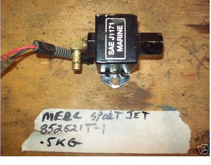

I have looked on the Crowley site. I have come up with this number, 15930A27, for a fuel pump assembly. 852521T1 for an electric assembly, which looks like this:
