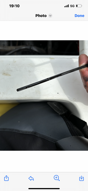

Recently picked up a really clean 2006 challenger 180 215hp SCIC..
Everything OK first couple times I took it out - only thing was if I hit the throttle hard from standstill it felt like it hit a revlimiter and I had to back off the throttle a bit and slowly build up speed- other than that ok.
The third time on the water.. after chilling on water with engine off for about 30 minutes, go to start and head to dock … it cranks and doesn’t fire.. after about 5 tries it fires up and just before I get to the dock I get a solid beep and engine oil light so immediately pulled the key. I restarted after few seconds and it was fine and I docked.
The following weekend we launched and after putting through no wake zone I accelerated and immediately got check engine light and a beep..so I pulled the key immediately. I restarted a couple times and kept getting this error.. while trying get back to dock on other side of no wake zone it was just a cycle of cutting out and restarting, I then got engine oil light and it went it a limp mode where it was moving at low rpm with a solid beep. Took boat out and on trailer it started up after 3 tries and idled no problem..took it home to flush it and it started right up first shot and idled etc no problem.
Oil was changed by mechanic right before I bought boat, coolant reservoir was filled to correct level, new plugs and carbon seal days before I bought it.
I checked the intake grate and pump - all is good from that angle - I didn’t see any obvious issues like objects sucked up or anything.
Where do I start? Do I need to order the candoo scanner ($449 on eBay) before I randomly replace parts? Any advice or recommendations would be greatly appreciated.
Thanks in advance, Dylan
