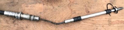

Some time ago I noticed that a seal on my original steering cable had failed.
Swivel seal for steering cable

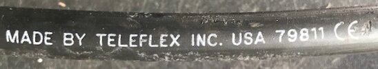

Steering was starting to show odd behavior as the cable became exposed to the elements and bent a bit. So I finally bit the bullet and ordered a new cable. I learned later that the original was made by Teleflex and had OEM #204390144, and I believe the mfg. no. is 79811.

Pulling the old cable out the cockpit was more challenging than I expected, in part because my old cable had become stiff near the stern because of water intrusion. I had to cut a cable tie that held the cable in place. This pinch point was roughly under the aft end of the starboard (driver side) carb cover. With several iterations on pulling from the cockpit and jiggling around in the engine compartment, the cable eventually came free.
